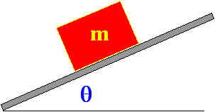

1. A block of mass m is resting on an inclined plane. The coefficient of friction between the block and the plane is 0.25. Determine the maximum value of the inclining angle?
  14.03                 0.25                 Explain
