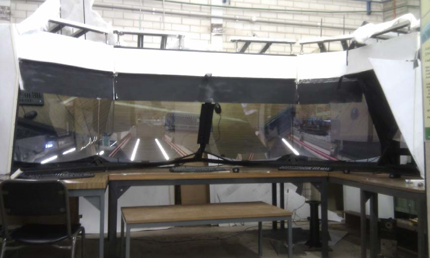

      In 2008 the RW McKenzie Centre fund management committee approved funding for PCs and LCD monitors to equip a new flight simulation facility in the Aeronautical Engineering sector of the School of AMME. This facility makes use of a large 5 segment collimator array recently decommissioned by QANTAS from their Boeing B747-200 flight simulator. The collimator was donated to SAMME but required fitting with new image generators and display systems. The Collimator is shown below, set up for integration and testing in the W & A Bennett Laboratory.

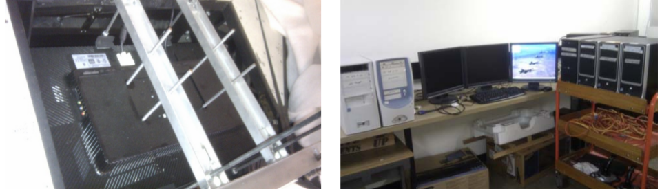

      The development of this facility is an ongoing project that will ultimately provide a static ground-based simulator with more open access than the existing motion-based VSFS. In the meantime, it provides students with thesis projects involving system integration as they work toward full implementation of the system. As of September 2011 the 5 primary LCD monitors have been installed in the collimators (see figure below showing a typical monitor installation from above). The PCs (also shown below) have been connected and visual calibrations of the 5 displays has been achieved. The displays have been successfully used to simulate aircraft motion and were on display and available for public trial on University Open Day in August 2011

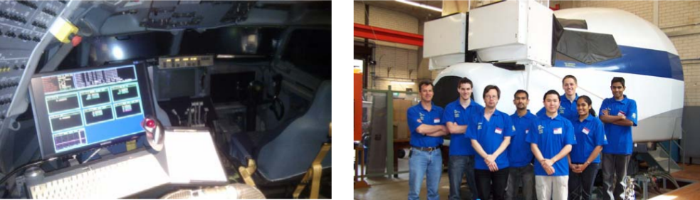

      The replacement monitor for upgrade of the Operator Station in the VSFS has been installed and is operational. This monitor is shown installed in VSFS below.

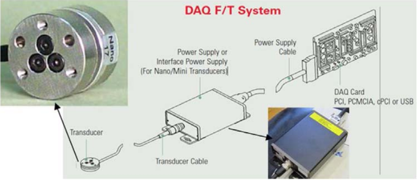

      One of the essential enabling resources for experimentation in Aeronautical Science and Technology would be the ability to measure multi-axis forces and moments of items being tested in airflow. Six- component load cells are needed, particularly for testing of models in wind tunnels, to measure the aerodynamic forces and moments acting on the objects being tested. The Aeronautical Group previously acquired an ATI Mini45 Force/Torque sensor system for general wind tunnel experimentation, so the ATI Nano17 Force/Torque sensor system was selected to provide a complementary capability for the testing of small models typical of mAVs (mini Air Vehicles) which require the detection of very low magnitude forces and moments.

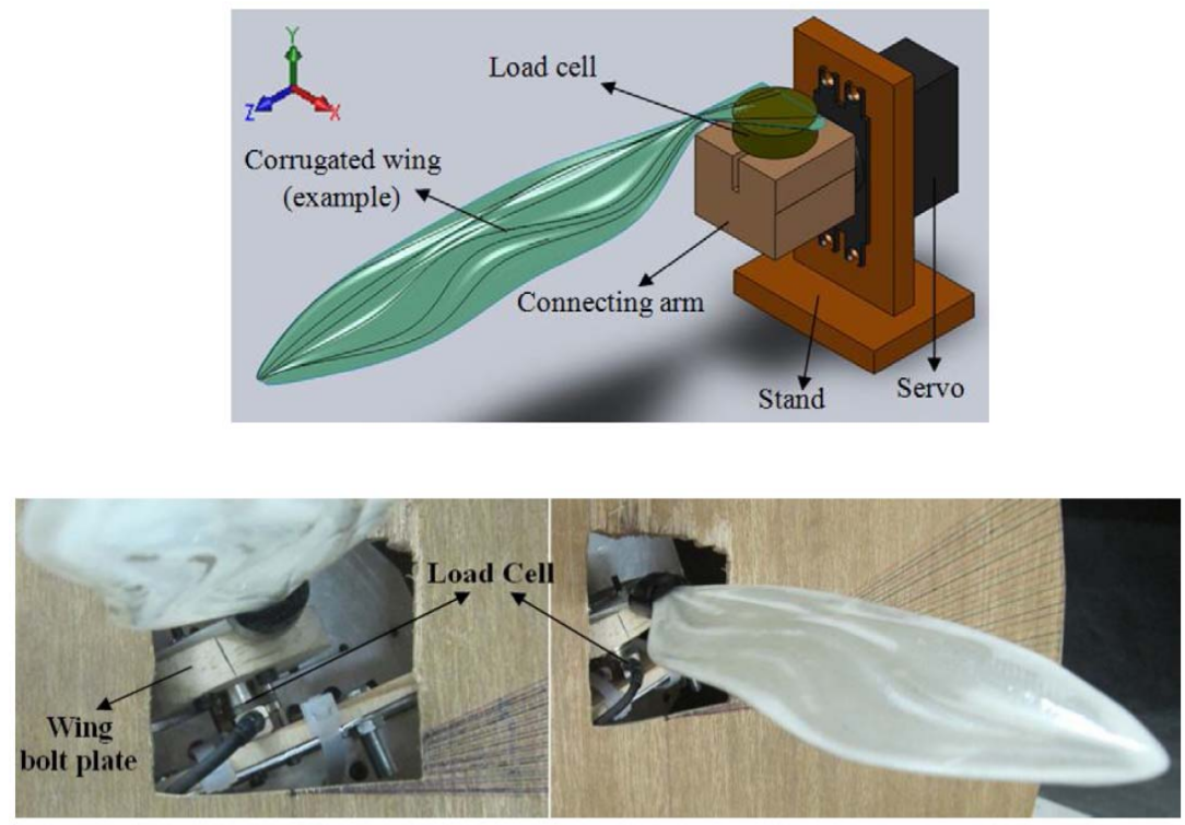

      One project which would not have been possible without the availability of this load cell was the investigation of effect of corrugations on the aerodynamic characteristics of a dragonfly wing in 2010. Models of wings mimicking the corrugated profile of dragonfly wings were tested against wings with conventional aerofoil and flat-plate profiles. The small wings were mounted on the Nano17 load cell and tested in a wind tunnel.

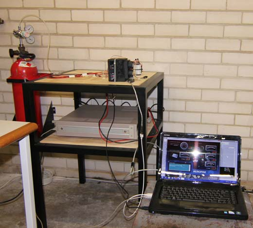

      Through the RW McKenzie Centre funding, the School of Aerospace, Mechanical and Mechatronic Engineering acquired an electronic load to drive the fuel cell, as shown on the photos below. Without this funding support, the acquisition of the electronic load would have been impossible and the test bench would have been far more limited in scope. The Aeropak fuel cell was acquired from a faculty start-up fund for Dries Verstraete. As such, the funding allowed the School to perform research on this cutting-edge technology and gain a significant understanding of the challenges associated with the use of this new technology.
      Fuel Cell and load integrated in test bench
